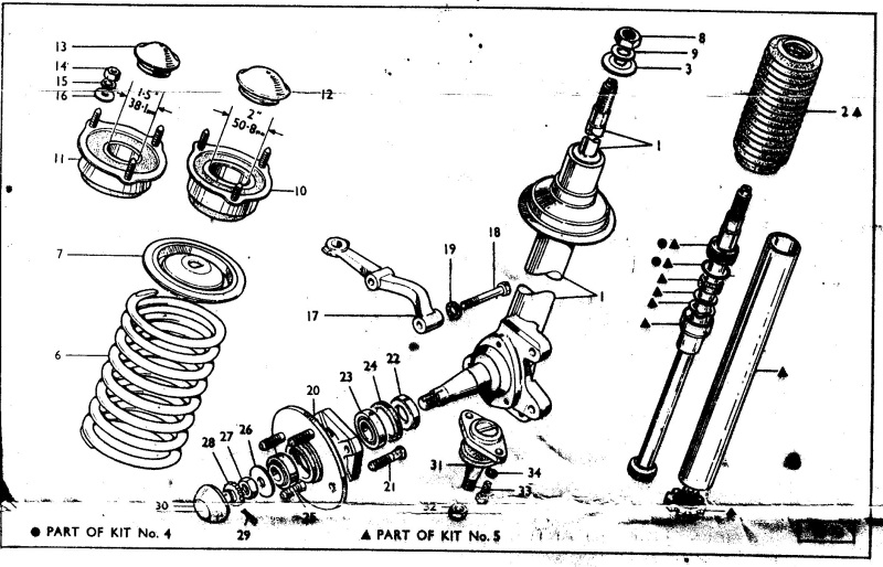

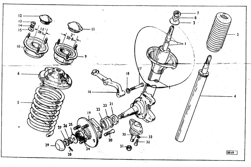

They must be universal fit as they are both on the diagram for early & late struts.
1922
551 Posts
Posted - 05 Aug 2013 :  13:09:44  Show Profile  Visit 1922's Homepage  Reply with Quote
99% certain they are interchangeable. It's just a different bearing. But it will check the parts book when I get home from work.

Can you use both versions of the top mount with either strut? I see both listed on each page.
1922
551 Posts
Posted - 04 Aug 2013 :  10:04:17  Show Profile  Visit 1922's Homepage  Reply with Quote
Early struts - up to '73
Later struts - from '73
To use the Sierra springs or anything similar you will need to later type struts.

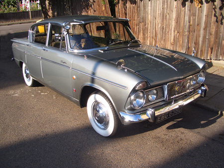

andyb
367 Posts
Posted - 25 Jul 2013 :  16:16:12  Show Profile  Reply with Quote
here you go luke
this chap uses his sceptre for classic rallying in Scotland
pictured here on last weekends great glens rally
had a quick chat with him when we marshalled on the saltire rally in march up near pitlochry
