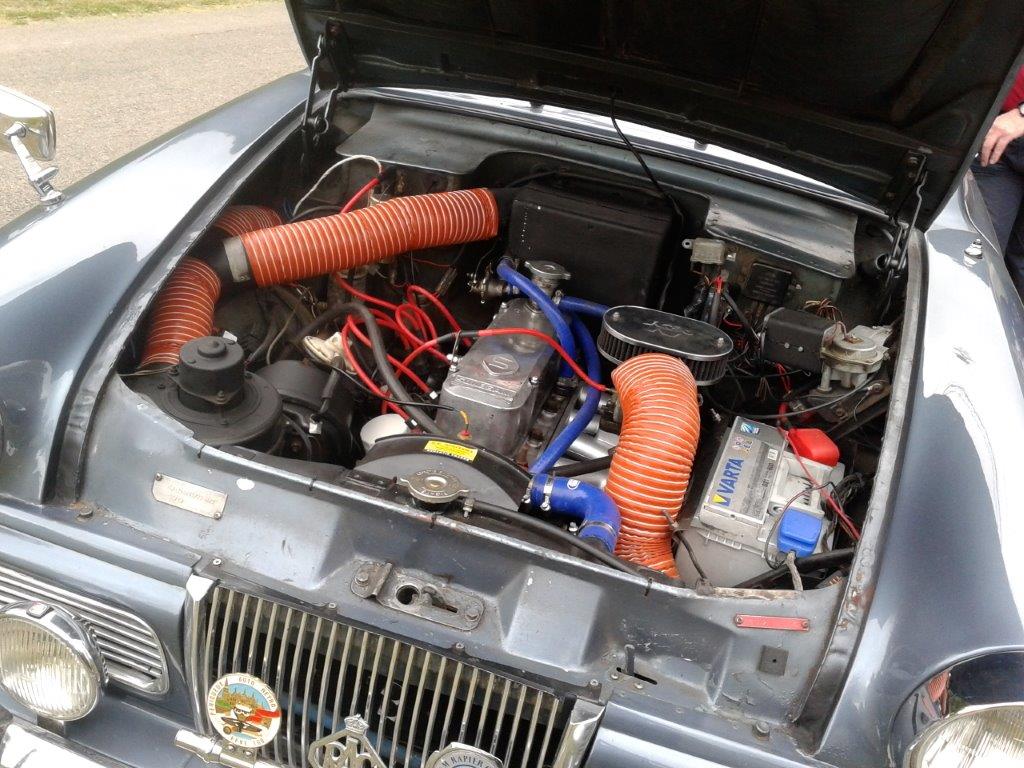

Just scanned your thread chaps. Will the plastic ducting used for the fresh air vents on the 'Arrow' range cars, work?
When I get the chance I'll have to measure diameter - it might be too narrow?
Also, yesterday met up with Forum Member Stella whilst here in France and her Series V has had replacement trunking, but not in black
Might be an option if you get totally stuck, but don't know where it was obtained.
Will let you know on the Fastback ducting. G.

oldcarnut
67 Posts
Posted - 26 Apr 2017 :  17:35:25  Show Profile  Reply with Quote
This red hose shown in the pic above is the same hose sold by the company I mention in my post above Car Builder Solutions. The hose they sell is either red or black and is 3-1/4" or 83mm ID which is correct for the Rapier.

Posted - 26 Apr 2017 :  21:02:47  Show Profile  Reply with Quote
Hi oldcarnut,
Thanks for your help and I also have noticed that the red hose on the picture is the same as the one shown in the advertisement of the company you have pointed out to us. The reason why I have not bought a hose from them yet is that I hoped to find a real black hose and not one with the white "rings" as can be seen on the photo. So I hope that Glen has some good news on the Arrow hoses. If not then I will certainly buy the black hoses from Car Buikder Solotions.
So you can be certain that I appreciate your help very much. Thanks again!

Hi All
We bought the best quality hose and this was the colour it came in.
Obtained from Merlin Motorsport
